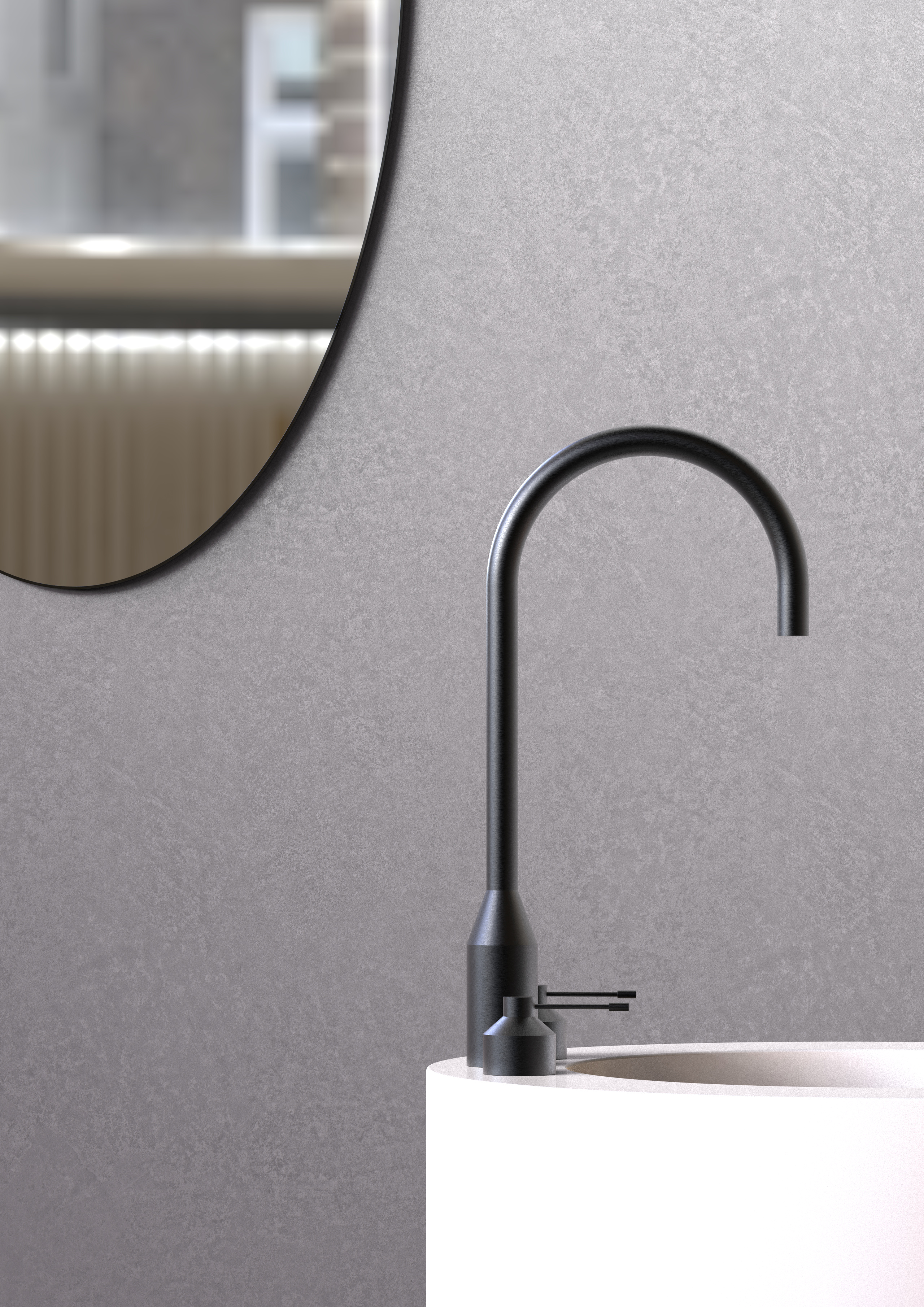

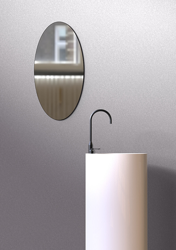

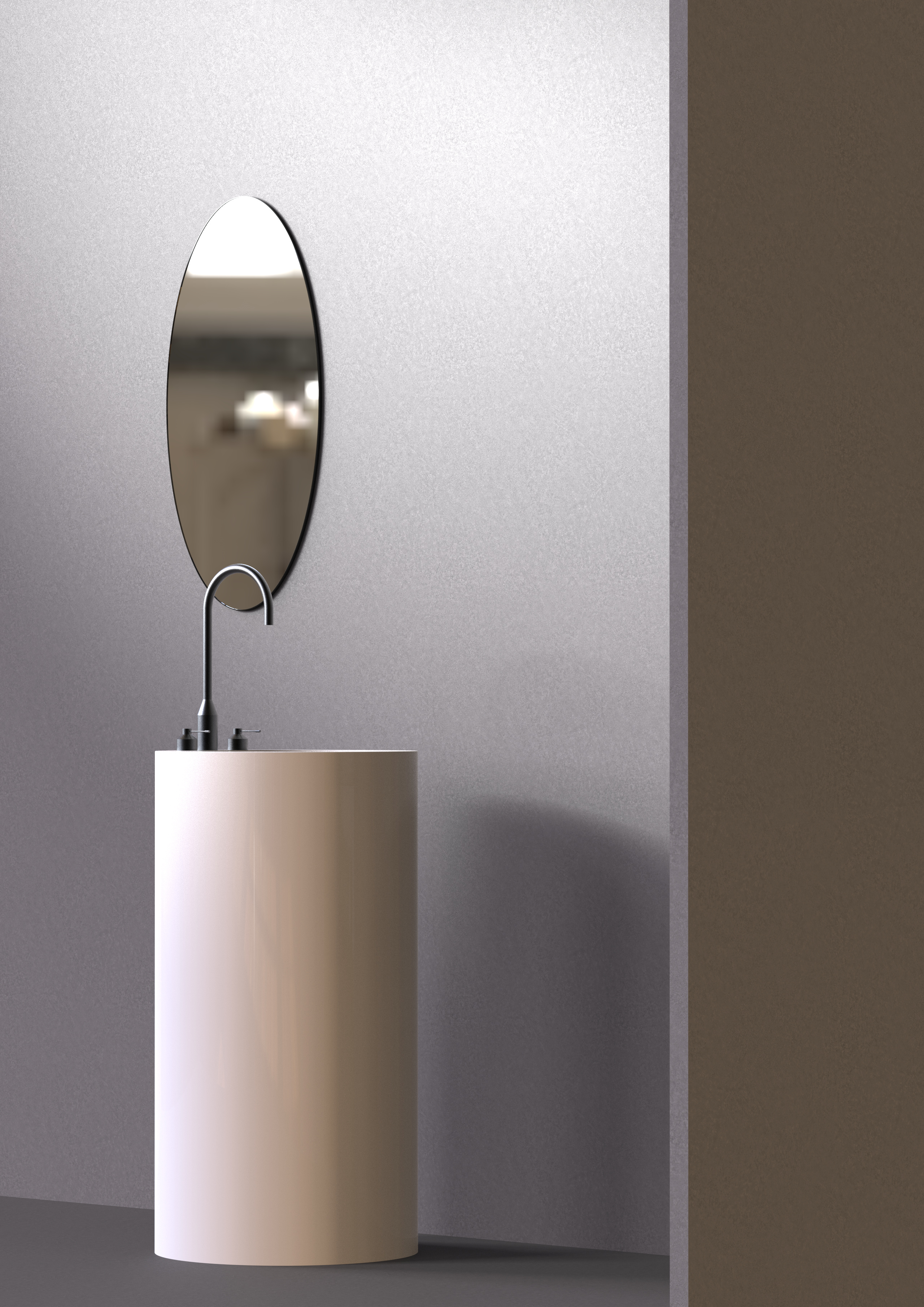

Here is my practice of minimal scene rendering, if you have any suggestion, please leave your comment, thanks

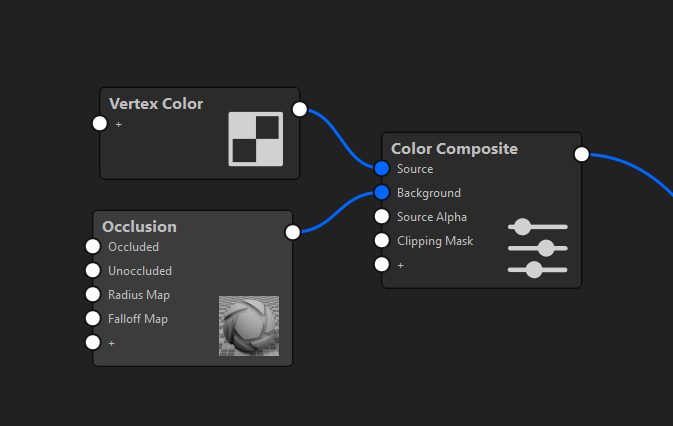

I like them! I just think where the sink hits the floor and where the faucet hits the sink it looks a bit flat/clean. I currently use the occlusion texture a lot combined with the colour/material of the object so you get a bit more natural occlusion shadows. The default value is pretty high but it’s easy to tweak and makes it often look more natural.
occlusion
Thanks for your advice, I’ll give it a try
The Vertex Color is a texture map or unity of procedure texture?
Basically it’s just a solid colour. So with metals I keep it most of the time white or light grey. But if you’ve paint or plastic I just copy the colour from the color/diffuse of the current material so that’s mixed with the ‘shadow’ from the occlusion.
The occlusion has really a high default, think 25 centimetres so most of the time I just reduce it to a few centimeters so it only impacts that area. If it’s still too much I reduce it a bit using the color composite slider of the background alpha.
